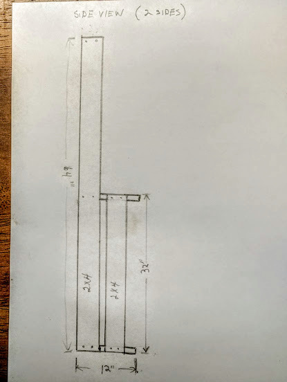

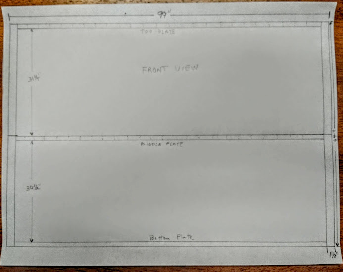

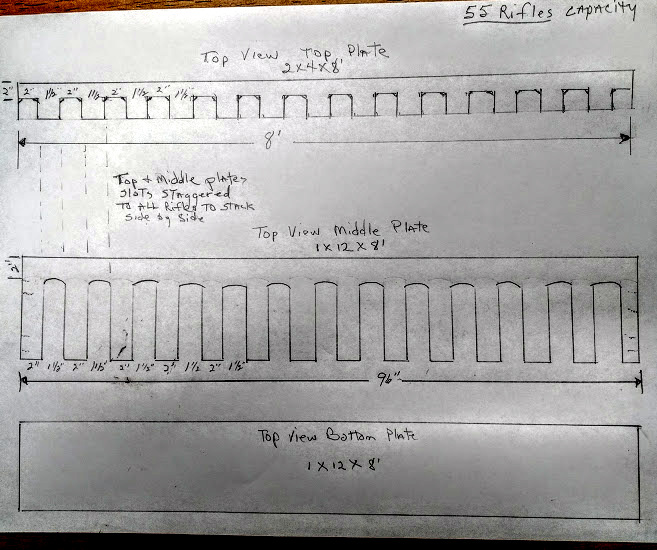

I just need to make some room in my walk in gun safe.
So I been trying to come up with ideas how to set up a rifle rack that would replace gun safes, and take up less space.
I have a wall thats 110" wide by 84" tall.
I got the paper and pencil out today and tried to lay out on paper what I have in my mind.
Here tis...
This is just my 1st draft, so if you can decipher it, and have any advice, or comments, I'd appreciate.
Any questions.

Safes take up a lot of space and never hold as many guns as what they advertise them for.:rolleyes:
I'm already making some modifications to that drawing.:eek:
Thinking of making that center plate with two 2x4s instead of one piece.
Slot the back one and use one to the front for the butt rest of he top rifles, and slip the barrel of the rifles on bottom rack up thru the 2x4s,

I like your idea, but like the arrangements at out LGS better. Wish I had a picture, but it's a horizontal rack. The barrels are placed into openings to the right, the wrists are placed on pesg to the left. There is a flat bar that fits over the pegs. The pegs are set into inlets in the bar. The top, bottom, and middle pe of pegs protrude and lock the bar tight.
