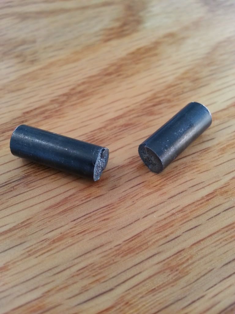

This little 10/22 has been interesting. Love the thing, it's just been a bit more than an out of the box shooter. At the range last Thursday my Bushnell kept unscrewing on the eye side every magazine. Every single time and it was shooting high left from the zero I enjoyed for a few weeks. At first I thought maybe a buddy had done something to it while I was messing with the mini. Then I got home to commence a quick clean. As usual the bolt stop pin fell out, but it made a different sound this time. Two sounds. Clink, clink... Ruger has one on the way post haste, but I'm going shooting at the friend's ranch today! So I prepped on the interwebs trying to find a MacGyver way around it. Interestingly, I found a lot of folks running without one!?! In the end I hustled down to the local smith and chatted him up. Hacksaw a bolt, razor off a shank from a nylon bolt or glue stick were his recommendations. After making four stop pins out of nylon stock the glue stick thing wouldn't let go. I found some 1/4" glue sticks at a hobby store and I've got a lot of glue sticks now. And a stop pin made from it. Racking the bolt and releasing it aren't shooting it, but that glue stick has made the entire receiver area MUCH quieter. I shall see if it works today.

Well, I'm back. It was a bit windy out there yesterday so most of my day was spent working through a 525 brick. Got my first prairie dog too! The glue stick was up first and it was quiet. It worked for 10 rounds no problem so in went the BX-25s for 50 more rounds. By the end of the first mag there was noticeable, slop, in the movement of the bolt. Kinda felt like the next quickly fired round was being slapped with a wet towel, if that makes sense. On round 58 a casing didn't fully eject so the glue stick was removed. It has visible little chunks and nicks and the ends were tapering off a bit. This made for a wiggle within the receiver. My verdict is it works for a few rounds, maybe more not fired so quickly. Definitely a band-aid and not a fix. The nylon bolt shank, however... Works BRILLIANTLY! Guess I never noticed the noise of a 10/22 before because every one I've been around was bone stock. The density of it is enough to make for a solid feel when shooting multiple shots and it does feel slightly softer to me. After adjusting myself (and scope) to the new kick my 10/22 is back in business.
